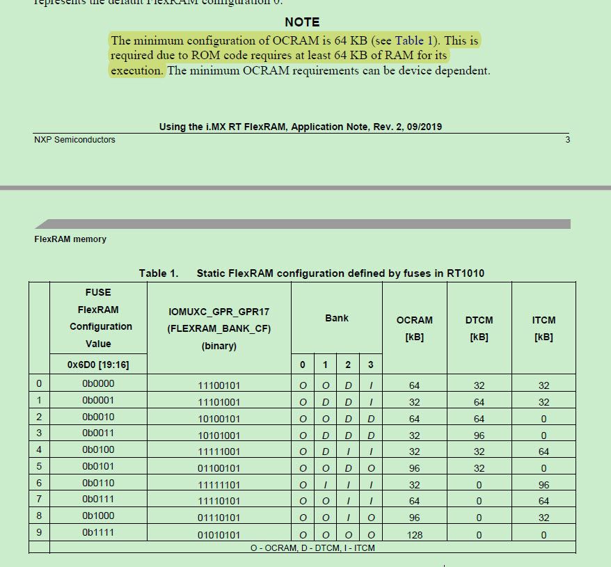

  Seems you didn't read the application note:
https://www.nxp.com/docs/en/application-note/AN12077.pdf
OCRAM at least leave 64KB, used for the ROM.
So you can't disable the OCRAM, you can see in the table, your configuration is not supported.
Kerry

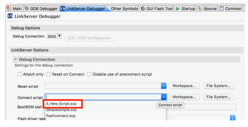

    Except modify the startup_mimxrt1011, you also need to add the .scp, give you an example in the attachment.
  Then in your Linkserver debugger, please also add it:
Beside this, the MPU configuration code also need to modify the related OCRAM, ITCM and DTCM size.
When you find your debugger can't be connected, you can enter the serial download mode, then erase all the external memory.
Then you can connect it again.
Wish it helps you!
If you still have questions about it, please kindly let me know!
Kerry

This doesn't work in general, since this connect script already reports that it cannot connect to the target, when it starts. So the solution must be done somewhere else.
Kerry

This is the restriction that I noted in my two posts made a week ago.
Also I repeat that I believe that this is a short sight in the ROM loader and I agree that OCR is not useful in most use cases.
The restriction can be worked around (also as detailed) and also debugging is possible (also explained).
It is also not restricted to i.MX RT 1011 but is true for all i.MX RT parts, but the i.MX RT 1011 is the hardest hit due to its limited number of FlexRAM banks.
Mark
