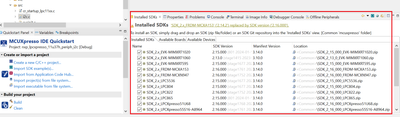

MCU Xpresso, fresh installation, V11.9.1, cannot load any SDKs.  The error displayed is, "Unable to load SDK update site or SDK update site not set..."  The hyperlink, https://mcuxpresso.nxp.com/eclipse/sdk results in an error message when nagivated to in a browser.
The 'Refresh' SDK Repository button in the 'Install MCUCpresso SDKs' tab results in the same type of error message.
NXP, could you please advise how to install and load SDKs (preferably via the IDE), or advise is the 'Refresh' feature in the MCUXpresso IDE is no longer available?

You can down load the SDK you need on the NXP official site.
Select Board | MCUXpresso SDK Builder (nxp.com)
And import the downloaded SDK in MCUXpresso.
And import the example in SDK.
