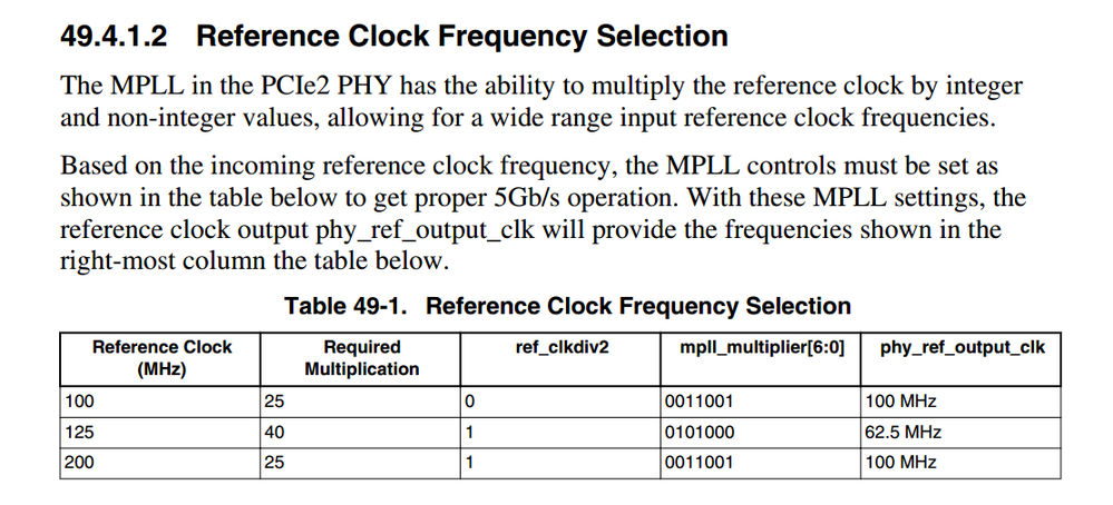

                                                                                 question about imx6 pcie's clock
      In the document of "reference manual", there are three source clocks for  phy_ref_output_clk, but how to select it ?
Refer as bellow:
linux version: 4.1.15

Hi jiang
by default 125MHz is used in imx6qdl.dtsi :
clks IMX6QDL_CLK_PCIE_REF_125M
linux-imx.git - i.MX Linux Kernel
also other clocks may be selected as described on
IMX6 PCI with external clocks
igor
