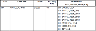

According to "i.MX 8M Mini Applications Processor Reference Manual", page 280, Table 5-1, the maximum clock frequency that can be used is 100MHz.

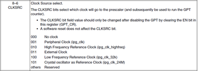

According to page 3855, 12.1.5.1, GPT Control Register, the clock source can be determined by setting bits 8-6 during the setup procedure of the GPT.
By editing the GPT driver, drivers/clocksource/timer-imx-gpt.c I tried all the variants, but the maximum clock frequency I got is 24MHz.
Please help me to configure that clock source to get at least 66MHz.

It looks like the clock driver, drivers/clk/imx/clk-imx8mm.c, defines the available clock sources for the GPT module in line 301:
301 static const char *imx8mm_gpt1_sels[] = {"osc_24m", "sys_pll2_100m", "sys_pll1_400m", "sys_pll1_40m",
302 "video_pll1_out", "sys_pll1_80m", "audio_pll1_out", "clk_ext1" };
This definition complies perfectly with Table 5-1.
However, the clock source is determined by bits 6-8 in the GPT control register, 12.1.5.1
How exactly are these 3 bits mapped to the structure imx8mm_gpt1_sels[]?
How can I figure out what is the frequency of "High Frequency Reference Clock (ipg_clk_highfreq)", or "Peripheral Clock (ipg_clk)"?
As I stated, any combination of bits I'm trying yields a maximum frequency of 24MHz. (I'm setting the prescaler to 1).
Can you please direct me how to set sys_pll2_100m as the clock source instead of osc_24m?
