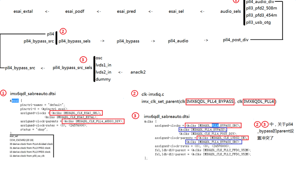

Hi NXP engineers,
On the 6qp_sabreauto board, ESAI use 24.576Mhz external osc as clock source,and the clock route is like this:
In the kernel code, only esai_sel is set by imx6qdl_sabreauto.dtsi to choose 'PLL4 divide clock':
I didn't see where pll4_bypass_src is set in the BSP code:
We need to use 24MHz osc as pll4 source,so we need to know where pll4_bypass_src is set in the BSP code(but we can't find related code).
Can someone explain this in detail? LilyZhangliqiang
Thanks!

igorpadykov
thanks, pll4_bypass_src is set in the BSP code in linux/arch/arm/mach-imx/clk-imx6q.c :
    clk[IMX6QDL_PLL4_BYPASS] = imx_clk_mux_flags("pll4_bypass", base + 0x70, 16, 1,
pll4_bypass_sels, ARRAY_SIZE(pll4_bypass_sels), CLK_SET_RATE_PARENT);
igor

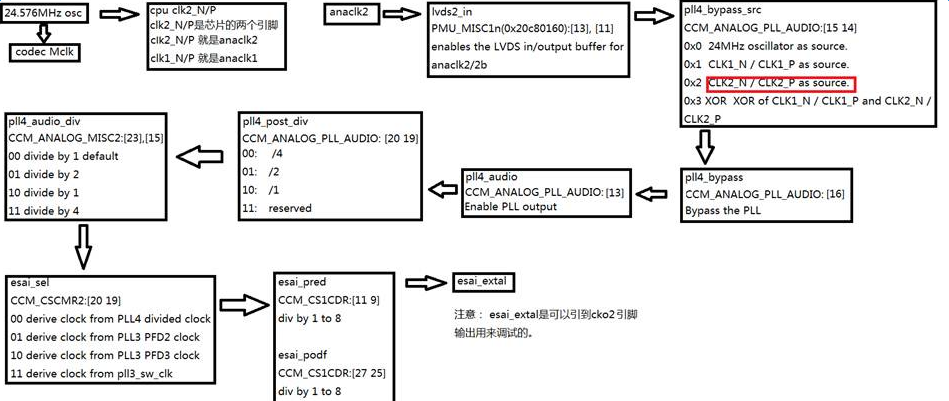

gelei
Hi igor,
the esai clk route for sabreauto board is as below:
1,367 Views
gelei
Ignore this topic. I know how imx6 sabreauto board handle  pll4_bypass_src now.
