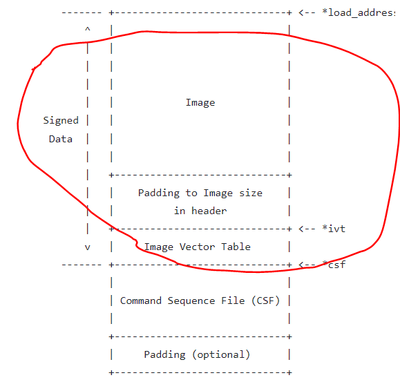

Currently I'm working on secure boot enablement, after I enable secure boot, I got a EVENT shown as below, how can I fix it? Additionally, here's my genIVT.pl & csf_additional_images.txt and Signed/Unsigned Images as attachement.
Authenticate image from DDR location 0x40480000...
Secure boot enabled
HAB Configuration: 0xcc, HAB State: 0x99
--------- HAB Event 1 -----------------
event data:
0xdb 0x00 0x14 0x43 0x33 0x0c 0xa0 0x00
0x00 0x00 0x00 0x00 0x42 0x70 0x10 0x00
0x00 0x00 0x00 0x20
STS = HAB_FAILURE (0x33)
RSN = HAB_INV_ASSERTION (0x0C)
CTX = HAB_CTX_ASSERT (0xA0)
ENG = HAB_ENG_ANY (0x00)
secure boot is already enabled:
u-boot=> hab_status
Secure boot enabled
No HAB Events Found!

It seems your signed data not including (paddings + IVT) in your CSF authenticate data.
Harvey

Ben_Teng
Hi @Harvey021 ,
Thanks for your help.
Right, that is the problem is.
Now I can boot the chip with secure boot.
Big thanks !
