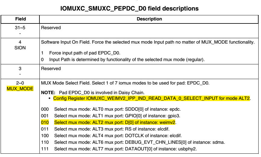

Now please explain how to configure shadowed EIM_D[0] to EPDC_D0.ALT2 as shown in the table when it's reset for NOR boot.
When I look at the IOMUXC register for EPDC_D0, the default value for MUX_MODE is 0001(GPIO[0]).
How can I set 010 for EIM_D[0]?
Also I have to set the SELECT_INPUT register to mode ALT2.
How can I do that?

igorpadykov
Nori,
there is no need for configuration of EIM_D[0]  EPDC_D0.ALT2
since NOR boot is performed on D16-D31 pads (selection
BOOT_CFG2[7:6]=01 - Not Muxed, 16-bit data (high half) interface)
EIM_DA0-15.ALT0 are for selection BOOT_CFG2[7:6]=00 - Muxed, 16-bit data (low half) interface
Shadowed pads are not used for boot.
igor

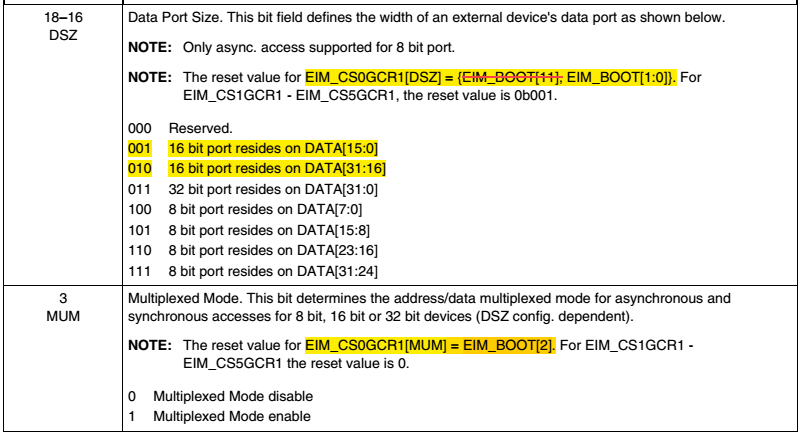

Let me confirm the Table 23-2 below
Is these correction in red are correct?
Because...
BOOT_CFG2[7:6]=00 - Muxed, 16-bit data (low half:DA0-15) interface
From 23.101.1 EIM_CSGCR1,
     MUM=1
     DSZ=001(lower 2bits applied)
So EIM_BOOT=0x101
BOOT_CFG2[7:6]=01 - Not Muxed, 16-bit data (high half:D16-31) interface
     MUM=0
     DSZ=010(lower 2bits applied)
So EIM_BOOT=0x010

it is not necessary to use 23.101.1 EIM_CSGCR1
since iROM changes these settings as described in i.MX50 RM Boot Chapter:
Shadowed pads are not used for boot. This corresponds to:
EIM_CS0GCR1[MUM] = ~BOOT_CFG2[6];
DSZ[0] = EIM_CS0GCR1[16] = ~ (BOOT_CFG2[7] | BOOT_CFG2[6]);
~igor

igorpadykov
Hello Nori,
yes, ROM sets EIM_CSGCR1 register
BOOT_CFG2[7:6]=00 - Muxed, 16-bit data (low half) interface  =>  DSZ = 001
BOOT_CFG2[7:6]=01 - Not Muxed, 16-bit data (high half) interface) =>DSZ = 010
DSZ[1] =~ (~(BOOT_CFG2[7] ^ BOOT_CFG2[6]);
~igor

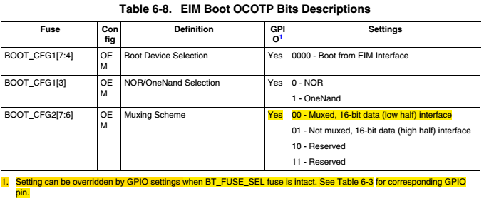

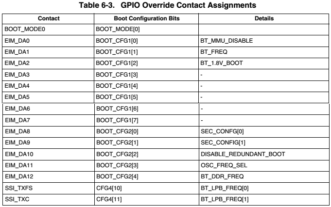

Thanks but you wanted to write
DSZ[1] =~ (~BOOT_CFG2[7] ^ BOOT_CFG2[6]);
Now it tuned out my customer has to use D0-15 pins to connect NOR FLASH for booting.
They need to set BOOT_CFG2[7:6]=00 by GPIO Boot Overrides as written in the Table 6-8 below
Then when I look at Table 6-3 to try to find out the GPIO pins but there are no "Contact" for BOOT_CFG2[7:6].
How can we really set BOOT_CFG2[7:6]=00?
BTW, EIM_BOOT[2:0] are internal signals generated by BOOT_CFG2[7:6]?
Nori Shinozaki

igorpadykov
Hello Nori,
yes EIM_BOOT are internal signals generated by BOOT_CFG2[7:6]:
EIM_DA14  BOOT_CFG2[6]
EIM_DA15  BOOT_CFG2[7]
~igor

igorpadykov
Hello Nori,
EIM_DA14 = BOOT_CFG2[6]
EIM_DA15 = BOOT_CFG2[7]
~igor
