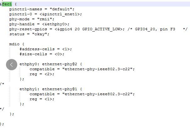

hello.
      I have faced a strange issues, that when I compiled the spi driver into the kernel, the PHY mdio can not get the chipID ex. got the value is 0xffffffff, but when I compile the spi driver to module,  and disabled ecspi1, the network is ok.
Is there a iomux confict?

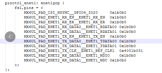

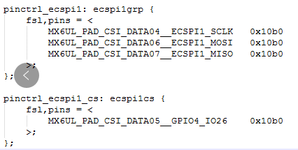

the following is the iomux define, pls tell me what's wrong?
ECSPI1:
FEC1:

guochgz
hi, igor
      the ecspi1 dts is the same with my ecspi1 define.
      how to check this hex num like 0x10b0, 0x1b0b0
   what does these fields mean?

this issue has been fixed, I have change nRST pins to another GPIO.
