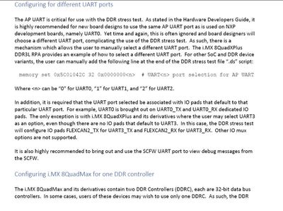

Hope Someone Can Help To Figure Out Following Questions For Some Hardware Design Problems Which Are Relevant For Boot / Debug.
First After Looking Upon Full Pages Of Application Processor Reference Manual I Find No UART Console Description For DDR Calibration / Boot Command Use. My Questions Are:
1. Here Should Be 1 UART Dedicated To The Purpose Of UART Console Then Developer Can Link The Designed Board Back To PC For Running DDR Calibration Tool And Stress Test And Booting Command. But I.m Not Sure Which UART Can Be Assigned For That.

1. for uart configuration one can look at sect."Configuring for different UART ports"
MX8X_DDR_Tools_quickstart_guide.pdf included in ddr test package

Where Is What You Mentioned Section About The Topic Of "Configuring For Different UART Ports"? And As I Know DDR Calibration And Boot Configuration Should Be Done By SCU. So I Guess The UART Console Only Support To Be Assigned For SCU?

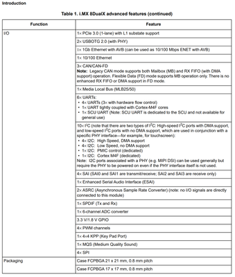

My Final Question Is That Only UART 3 LPUART Can Be Set Up For Boot Configuration And As Console For IOMux / DDR Calibration? I See According To Datasheet Page 4 SCU Is Only One UART Dedicated For Specific Purpose. Does The Specific Purpose Mean IOMux And Console?
And According The Discussion:  chaning the Debug port i.MX8QXP That You Referred To Me They Would Like To Set Up UART 3 Instead Of Using Default UART0 That Applied In Evaluation Board. Does That Mean In MEK Board SCU UART Is Not Used But UART 0 Through SCFW API For Doing IOMux And Being Boot Console In Connection To PC?
