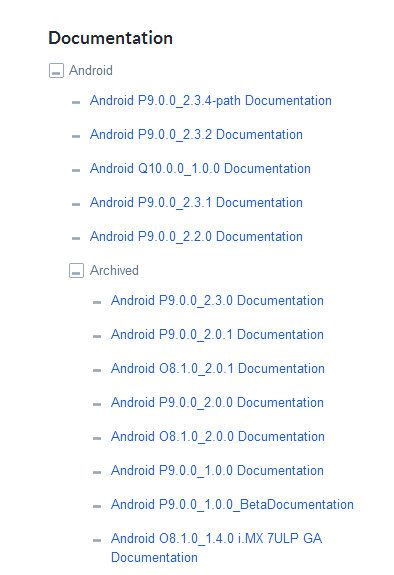

Also when you ask "Android (9.2.3)"  - what do you mean, as there is no
such Andoid release name on below link with description of all BSPs ?
i.MX Software and Development Tools | NXP
igor
