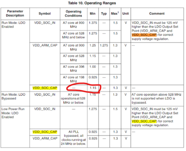

datasheet (old)

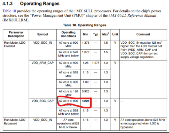

However I found that fsl,soc-operating-points (VDD_SOC_CAP) should be 1.25V because 1.175V is old datasheet value and was updated in the latest kernel. (refer to https://github.com/varigit/linux-imx/commit/c3e4be705852c6d973d3b1f2b8b024fdea7303af)
dts (should be updated to this)
fsl,soc-operating-points = <
				/* KHz	uV */
				900000	1250000
				792000	1175000
				528000	1175000
				396000	1175000
				198000	1175000
new datasheet
 https://www.nxp.com/docs/en/data-sheet/IMX6ULLCEC.pdf
history
It seems that VDD_SOC_CAP is for L1/L2 caches voltage.
(See attached file)
In my understanding, read/write from ROM/RAM will sometimes fail depending on a board.
However the circuit is not open and I am not sure what will occur.
What will occur if I set VDD_SOC_CAP 1.175V at 900MHz and why?
Why did you update the voltage at 900MHz?
