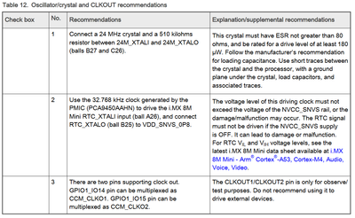

Hi, Chavira
After some investigation we decided to check the operation of the 24MHz oscillator with the oscilloscope. In our board we use the ECS-240-10-37B2-CWN-TR oscillator. On the XTALOUT line we didn't see frequency generated after the suspend wake interrupt sent. However, after the line is released from the oscilloscope, device wakes up from Suspend after short period of time and the frequency can be observed on the line being generated correctly.
Given the observations, we think that the reasons may be in the absence of feedback resistor near the oscillator and/or in the hardware placement of oscillator on the back side of the board relatively to the CPU, which is dictated by the area constraints of the board. If you have any further suggestions about the matter, would greatly appreciate it
Best Regards
2,300件の閲覧回数
Chavira
Hi @AlexandrP!
The recommendations are the next:
