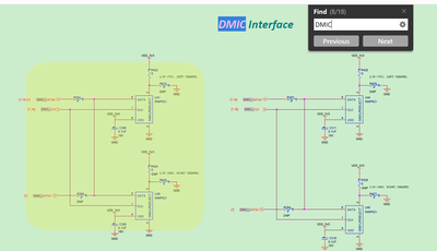

Hello everyone,
I want to learn to use the four DMICs on RT1170-EVK, but I can't find any examples of DMICs and driver files like fsl_dmic.c and fsl_dmic.h in SDK2.11.0. Does NXP have some introduction and Demos for DMIC on RT1170?

Hi @Shawn_ ,
   Thank you for your interest in the NXP MIMXRT product, I would like to provide service for you.
   To the RT1170, it doesn't use the DMIC IP, it is using the PDM ad the DMIC IP.
   Please refer to this code:
\SDK_2_11_0_MIMXRT1170-EVK\boards\evkmimxrt1170\driver_examples\pdm\pdm_sai_multi_channel_edma
  It will use the EVK on board U40,U41 DMIC.
So, your used driver is fsl_pdm, fsl_pdm_edma.
Wish it helps you!
Kerry
