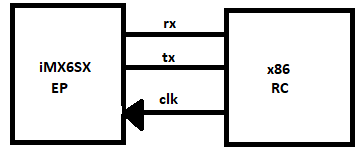

we are trying to connect
  • iMX6SX cpu
  • x86 module
by PCIe.
The iMX6SX must be a PCIe Endpoint.
I need only shared memory between iMX6SX and x86. I do not need interrupt.

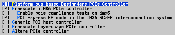

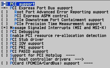

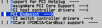

On 4.14.98 I have seen an option in menuconfig.
but I don't think it is the right way to follow.

This is our PCI system:
The clk is the PCIexpress 100 MHz LVDS clock.
It is connected to the CLK1p, CLK1n pins.
Q1 : Is the standard DTS ok for this configuration ?

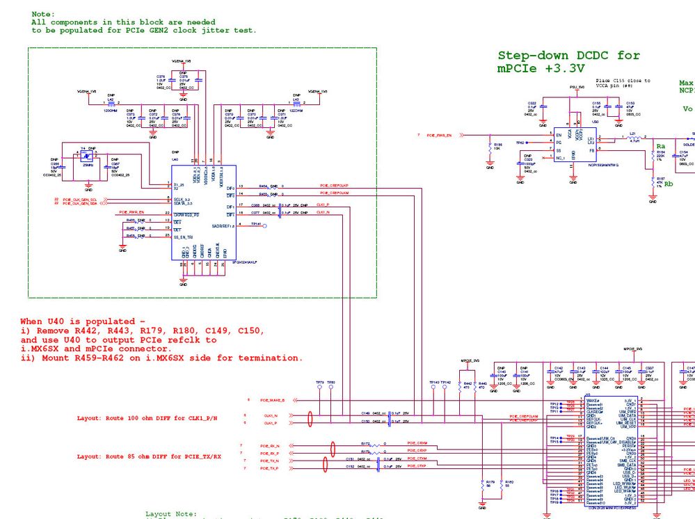

igorpadykov
Hi Paolo
from log (" linux-imx-imx_4.9.88_2.0.0_ga-var01") seems you are using
some of variscite (Leading ARM System On Module (SoM) designer and manufacturer | Variscite )
boards. I am not familiar with them, NXP i.MX6SX reference board uses external PCIe clock, below
part of i.MX6SX Sabre SD schematic:
i.MX 6SoloX SABRE Development Board | NXP
