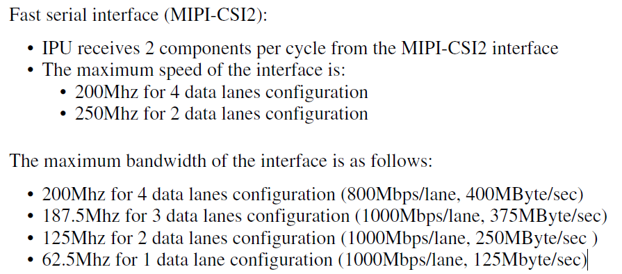

Q2:
According to Page 2791 of RM, it can be supported as it looks.
Does the description mean that the max frequency is 125MHz at each lane ?
I think the two description is different each other.
Which one is correct ?

Yuri
  The considerations of the first item (Q1) relate to parallel interface,
strictly speaking, they are not suitable for serial MIPI CSI-2.
As for the serial MIPI, for 1, 2 or 3 lanes maximum throughput is 1000 Mbps/lane,
assuming 125 Mbyte/sec. For 4 lanes  - 800Mbps/lane
Yuri.

As for MIPI speed, I'm planning to use two lanes.
If I use two lanes, the maximum throughput is 2000 Mbps, assuming 125 MByte/s.
In my undesstanding, I can calculate the required througput from following way.
The required throughput = Frame height * Frame width * Frame rate * Blanking intervals * The amount of data per pixel
So when I use 1080p@60fps in RGB444, I need 480 MByte/s.
1920 * 1080 * 60 * 1.35 * 24  = 3,844 Mbit/s ⇒ 480 MByte/s
From the above results, MIPI CSI-2 I/F cannot support 1080p@60fps in RGB444.
Is it correct ?
