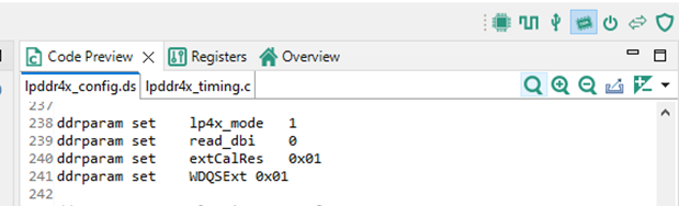

Hello community,
I have one question about i.MX93 DDR PHY function.
Does i.MX93 support WDQS?
In following thread, it say that i.MX8M Plus support WDQS when WDQSEXTENSION is enabled.
https://community.nxp.com/t5/i-MX-Processors/Is-IMX8M-Plus-using-WDQS/m-p/1877743
But, it have no WDQSEXTENSION bit in i.MX93.
Does it have another method to "write and masked write operation DQS control"?
Ishii.

HI, @takayuki_ishii
i.MX93 support WDQS feature.

bernhardfink
We don't document the registers of the DDRC PHY, but for this specific feature (in fact this is a requirement of JESD209-4B) you find at least an indication that it is enabled:
In the lpddr4x_timing.c file you can't identify this bit without having a detailed description of the registers, but as Pengyong wrote, it is enabled by default.
Bernhard.
