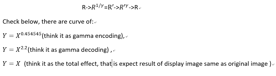

1.Introduce gamma

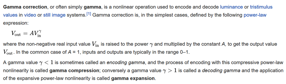

The gamma, gamma correction, gamma encoding, gamma compression , these words all related one kind operation , see wiki page of it:
The device used for image capture/print/display follow this power-law.

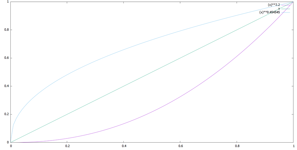

For example the camera captured image , to view this image on display device as good as original captured image : gamma encoding when camera saved sensor data to image file,  and  gamma decoding when that image file display on your PC LCD monitor.
That is :

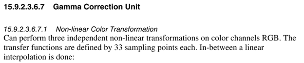

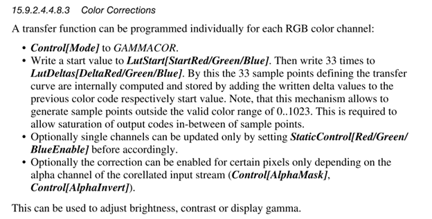

2. i.MX8QXP Display Controller Gamma Correction Unit
The Gamma Correction unit position is located between Frame Gen unit and TCon unit.
More detail see below contents from i.MX8QXP RM:
So GammaCor unit could be used as adjust display gamma , or brightness or contrast.

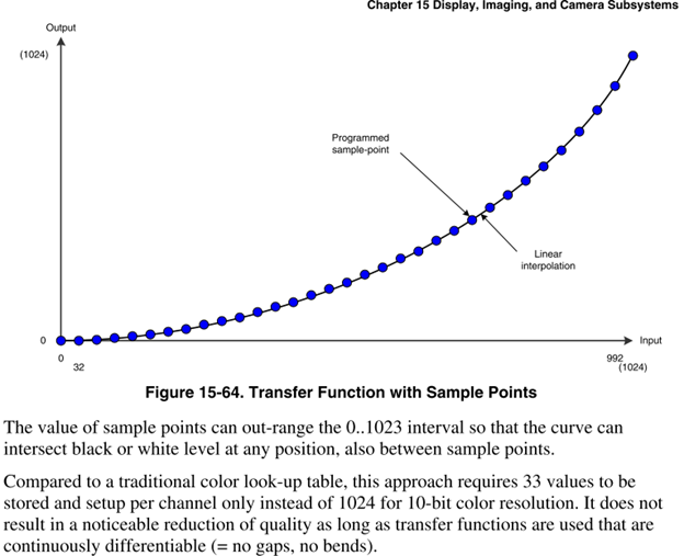

To used it, need follow the steps at RM 15.9.2.4.4.8.3.
Something need to note:

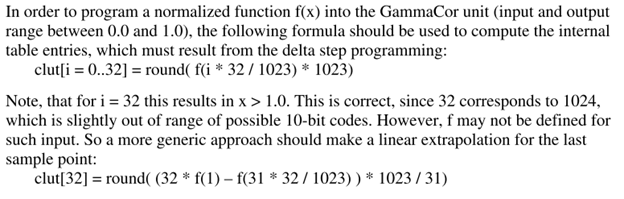

You need program 33 sample point value into the register, these sample point value range is from 0 to 1023. Note, first write is start sample point value , then the other is delta value: current sample point minus previous sample point value.
You can use GammaCor unit on any channel of R/G/B.
If you use normalized function f(x), the following formula should be used to
clut[i = 0..32] = round( f(i * 32 / 1023) * 1023)
