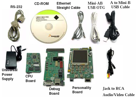

Unpack the kit
![IMX31-PDK-Contents.png IMX31-PDK-Contents.png](/t5/image/serverpage/image-id/37833i620FB44BF81DB6B2/image-size/large?v=v2&px=999)
- Boards
- CPU board
- Debug board
- Personality board
- Cables
- RS-232 serial cable
- Ethernet straight cable
- High-speed USB cables with mini AB connectors for OTG
- High-speed cable with standard A to mini B connectors
- Mini-USB adaptor
- Jack to RCA audio/video cable
- Power Supply
- 5.0V/2.4A universal power supply kit
- Paperwork
- CD-ROMs: Content CD
- End-User License Agreement
- Quick Start Guide (this document)
- Warranty card
- Freescale Support card

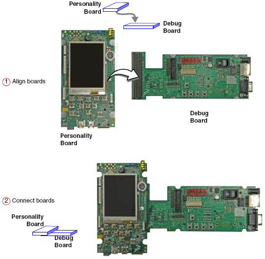

Connect the Personality board to Debug board.
The personality board connects to the Debug board using a 500-pin connector. The connector is keyed to avoid misconnection, so there is only one way to connect these boards.
![Build_imx31-pdk_development_step1.png Build_imx31-pdk_development_step1.png](/t5/image/serverpage/image-id/37834iA352B835355EC318/image-size/large?v=v2&px=999)

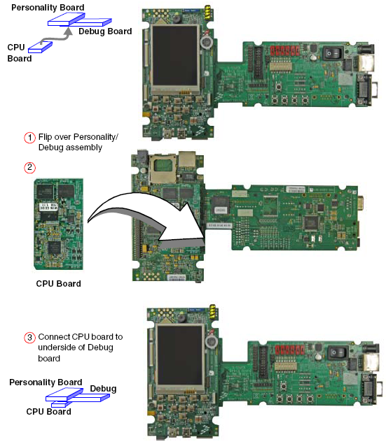

Then, connect the CPU board to the underside of Debug board.
![Build_imx31-pdk_development_step2.png Build_imx31-pdk_development_step2.png](/t5/image/serverpage/image-id/37835i6EEBA551AEDA35C6/image-size/large?v=v2&px=999)

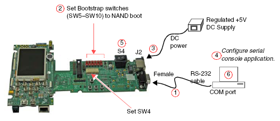

Connect platform to PC
To connect the 3-Stack platform to your host PC:
![Connect_imx31-pdk.png Connect_imx31-pdk.png](/t5/image/serverpage/image-id/37865i95E191BA7F750725/image-size/large?v=v2&px=999)
- Connect one end of an RS-232 serial cable (included in the kit) to a serial port connector (CON4) on the Debug board and connect the other end to a COM port on the host PC.
- Configure SW4-1 to ON.
- Make sure that SW4-8 is ON, to supply power to all three boards.
- Configure SW4-2 to OFF.
- Confirm that the Bootstrap switches (SW5–SW10) are set for external NAND boot (see more here)
- Connect the regulated 5V power supply to the appropriate power adapter. Plug the power adapter into an electrical outlet and the 5V line connector into the J2 (5V POWER JACK) connector on the Debug board.
- Start a serial console application on your host PC with the following configuration:
Baud Rate | 115200 |
Data Bits | 8 |
Parity | None |
Stop Bits | 1 |
Flow Control | None |
- On the Debug board, switch the power switch (S4) to 1.
- The OS image pre-loaded in the 3-Stack board will boot and the debug messages from the bootloader should now appear on the serial console application on your PC
