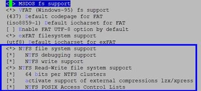

1.You can enable ntfs support in kernel config as below,  ntfs can be mounted normally, but you can only modify existing file content in disk, you cant create/delete/rename file on disk.
> File systems > DOS/FAT/NT Filesystems

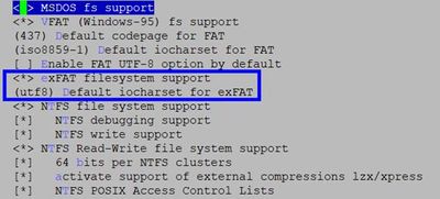

3.exFAT is not supported on this BSP..
L6.1.22(you can check it on L5.15 and above, should be the same)
  1. You can enable ntfs support in kernel config as below, full features can be supported.
> File systems > DOS/FAT/EXFAT/NT Filesystems
  1. Pls use -t ntfs3 during mounting, otherwise it will be mounted as read-only
  2. Log:
root@imx8ulpevk:~# mount -t ntfs3 /dev/sda1 /mnt/fat/

  1. exFAT has been supported in L6.1.22.
/dev/sda1 on /run/media/sda1 type exfat (rw,relatime,fmask=0022,dmask=0022,iocharset=utf8,errors=remount-ro)
