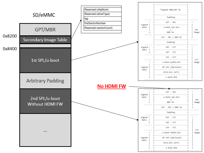

Tips collected from zhaoyang-b49593 and dandouglass-b41520 while enabling redundant boot:
Using i.MX 8MQ, same method can be applied for other i.MX devices that support redundant boot, see SoC Reference Manual.
As described on the RM, if primary image authentication fails the ROM can reset and try booting a secondary image.
This feature is only available on closed mode with properly signed binaries, otherwise the ROM boots the primary image despite the auth failure.
For the i.MX 8MQ, the secondary image must start with spl, not HDMI firmware.
Note, there is no ROM redundancy for the hdmi fw, if it is corrupt user can store a 2nd copy on a different memory address and update at run time.
Steps to generate a dual spl image:

5. Create dual bootloader image
We can concatenate our binaries to create a single file, let's use 2MB distance between primary and secondary images:
For the working primary image:
objcopy -I binary -O binary --pad-to 0x200000 --gap-fill=0x00 signed_flash.bin 1st-spl_pad.bin
cat 1st-spl_pad.bin secondary2_nohdmifw_signed_flash.bin > 1st-spl_pad_2nd-spl.bin
Or for the corrupt primary image experiment:
objcopy -I binary -O binary --pad-to 0x200000 --gap-fill=0x00 signed_flash_corrupt.bin 1st-spl_pad.bin
Program it to the SD card on 0x8400 offset (33k)
dd if=1st-spl_pad_2nd-spl.bin of=<sd path> bs=1024 seek=33 && sync
6. Add Secondary image table
Follow the format on the RM, this is only 20 bytes long.
For a 2MB distance between the table and the secondary image we can use "0x1000" on the firstSectorNumber field.
2MB/512 = 4096 (0x1000)
The perl script attached, genSecTable.pl, can be used to generate it.
perl genSecTable.pl 0x1000
Program it to the SD card on 0x8200 offset
dd if=secTable.bin of=<sd path> bs=1 seek=$((0x8200)) && sync
7. Verify secondary image is booting
