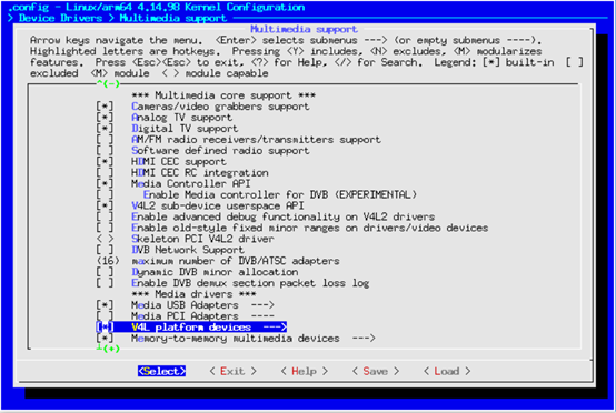

5) enable the camera module in the kernel
if the camera format is raw10 and raw12, don’t forget to enable the fsl,two-8bit-sensor-mode in the device tree
After modified all of source code you need, enable the camera module in the menuconfig by command “bitbake -c menuconfig linux-imx”

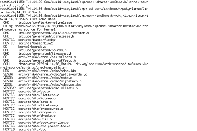

then use the command “bitbake -c compile -f linux-imx” and “bitbake linux-imx”, the ko file and new dtb file are supposed to be found under “/build-xwayland/tmp/work/imx8mmevk-poky-linux/linux-imx/4.14.98-r0/build/drivers/media/platform/imx8” and “/build-xwayland/tmp/work/imx8mmevk-poky-linux/linux-imx/4.14.98-r0/build/arch/arm64/boot/dts/freescale” but one couldn’t find new dtb file, if you use the kernel in standalone environment, one can use “make dtbs” to build the new dtb file, but in yocto environment, try to use “bitbake -c devshell linux-imx” before “bitbake linux-imx”, this command is for opening a new shell where with necessary system values already defined for linux-imx, then change the folder and build as below
After building, you can find new dtb file under “/build-xwayland/tmp/work/imx8mmevk-poky-linux/linux-imx/4.14.98-r0/build/arch/arm64/boot/dts/freescale”
Then “bitbake linux-imx”
