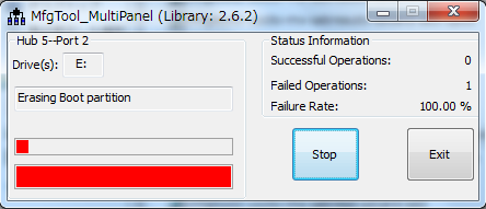

Some our customers want to use the mfgtool to download the images to QSPI and boot up. When download the demo images on our website (Linux 4.1.15) to the QSPI-NOR on IMX7D SABRE-SDB. The error occurred as follows:
Is it able to program the QSPI-NOR on i.MX7D SABRE-SDB by using MFG-Tool?
Answer is yes.
In the above error message we can see that the system can not find and detect the qspi, so it can not excute the following code,<CMD state="body="$ flash_erase /dev/mtd0 0 20">Erasing Boot partition</CMD>Updater" type="push" when use the mfgtool to download the images to the QSPI-NOR .
The board i.MX7D SABRE-SDB and default BSP are boot up from EPDC.  Here customer want to boot up from QSPI, When using QSPI, you need to de-populate R388-R391, R396-R399 and populate R392-R395, R299, R300 in your hardware. QSPI signals are muxed with EPDC_D[7:0]. You can see the schematic, details you can see as follow.
After hardware modify, you can use the mfgtool2-yocto-mx-sabresd-qspi-nor-mx25l51245g.vbs to download. And then boot up from qspi, boot mode you can refer to the schematic boot up setting.
