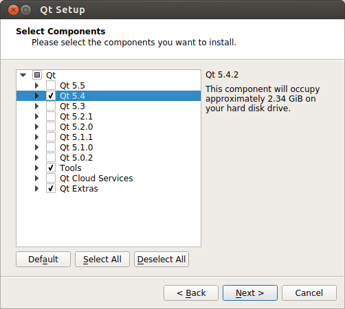

After the information from the repositories has been fetched you will be asked where to install Qt Creator.
Then you will be asked which components to install. We will install Qt 5.4 which is the one supported on the 3.14.28 BSP release.
You will need to accept the License Agreement and then the installer will fetch and install the necessary files.

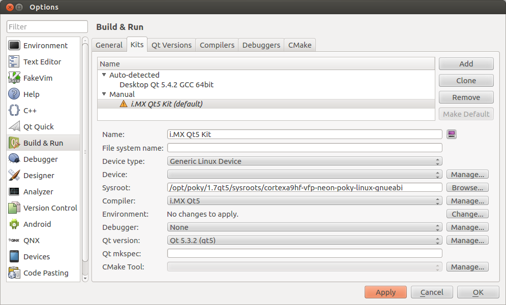

Finally, on the Kits tab add a new kit and select the sysroots from the toolchain, which is by default located in:
/opt/poky/<VERSION>/sysroots/cortexa9hf-vfp-neon-poky-linux-gnueabi
Qt Creator is now configured for building for the i.MX6.

Dear Yuri ,
We have followed the steps  as per the above mentioned steps
Could not start Process
Error while building /Deploying projects when executing step make
In build &Run -> Qt versions : /opt/poky/1.6.2/sysroots/x86_64-pokysdk-linux/usr/bin/qt5/qmake
at the time we get a notification like no compiler can produce code for this qt version.
could you please help me, to solve this issue

Hello Sachu Sanal,
I would recommend double checking that you are using the qt5 toolchain. You may extract this toolchain using the meta-toolchain-qt5 recipe.
Other than that I did not see anything that may be incorrect but I would like to double check if you disabled all other Kits except for the one you created for Qt5 on the Kit Selection screen when creating the new project.
