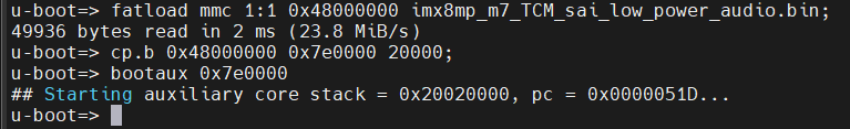

I like doing the previous step so I can see the result of the next commands issued in U-boot to load the M7 image.
fatload mmc 1:1 0x48000000 imx8mp_m7_TCM_sai_low_power_audio.bin;
cp.b 0x48000000 0x7e0000 20000;
bootaux 0x7e0000
Here is an screenshot that shows how the U-Boot's response should look:
U-Boot response when loading the SAI low power audio example to the Cortex M7U-Boot response when loading the SAI low power audio example to the Cortex M7

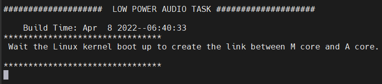

That should have prompted the following message on the M7 terminal:
M7-core is up!M7-core is up!

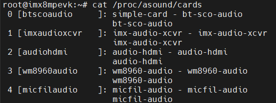

Confirm that the WM8960 is listed as audio card as follows:
 cat /proc/asound/cards
           Listing avaialable audio cards. WM8960 should be present.Listing avaialable audio cards. WM8960 should be present.
Make note of the list. The wm8960 is listed a the third sound card.

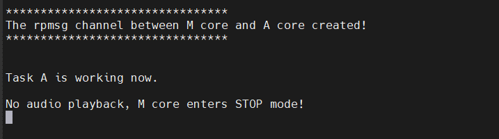

This is what you should see on the M7 side:
Stop the GStreamer pipeline issuing CTRL + C. M7 shall warn you about that:
NOTE: you can use the aplay command to play audio as shown on [2]. However, I consider using a testsrc is much quicker and flexible for a quick test.

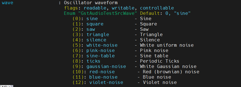

Feel free to go ahead and tweak the GStreamer pipeline to change audio test source properties. audiotest src.
This command will let you know the available options:
 gst-inspect-1.0 audiotestsrc
            NOTE: you can navigate through the displayed list using the “d”key. Press “q’’ to quit.
For example:
For example, I am reproducing sound using a different setup based on the list above:
gst-launch-1.0 audiotestsrc freq=4000 volume=0.8 wave=8 ! alsasink device=hw:3
