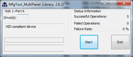

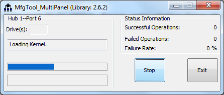

  9. Press "Start" button. Downloading should start. Executed steps are visible in the debug terminal.MfgTool_starting.png

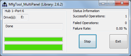

  10. When you see "Done" printed, downloading has succeeded.MfgTool_success.png
    1. Set boot switches on SW602 [2:1] to off:on, SW601[4:1] TO off:on:off:on
    2. Reset i.MX 6UL EVK (or power off then on), and boot to Linux.

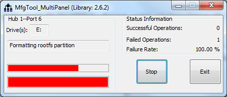

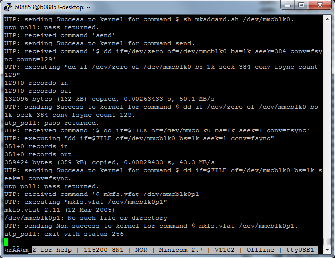

  11. In case of any error, inspect serial output on debug terminal to see what has gone wrong.MfgTool_error.pnglog_error.png
