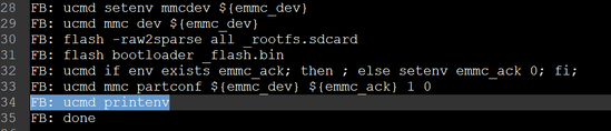

At this point we can edit the built in scripts to add our custom commands, for this guide I'll add the printenv uboot command at the end of the flashing process.
For this I'll enter the folder mfgtools/uuu, and edit emmc_burn_all.lst with any text editor, i.e. Notepad ++, add the command FB: ucmd printenv.
Save and close the editor, it is possible to add most uboot commands like for example the fuse commands to burn eFuses.

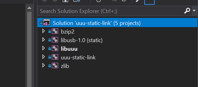

Then we can now build the tool, opening msvc/uuu-static-link.sln with Visual studio, select solution uuu-static-link.sln

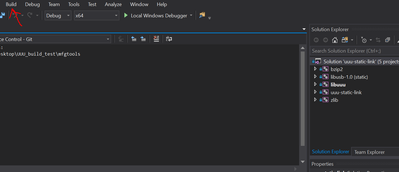

And finally build the solution:

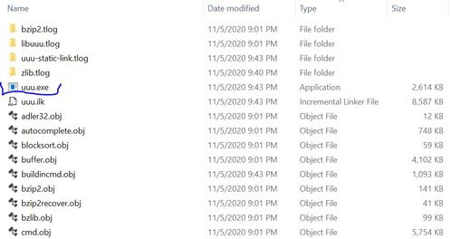

The executable (uuu.exe) would be at the following path:
mfgtools\msvc\x64\Debug
