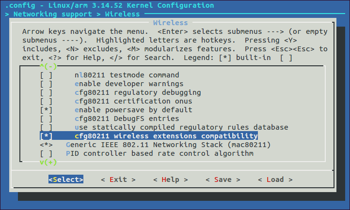

First, run the menuconfig tool on the bitbake environment:
bitbake linux-imx -c menuconfig
Enable the necessary options:
Networking Support > Wireless > cfg80211 wireless extensions compatibility
Save the configuration and exit. Then run the following bitbake command, which will create a config fragment file that contains the changed made to the default kernel options.
