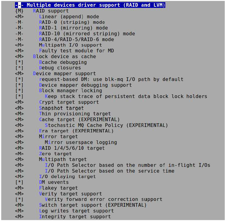

Then we will add RAID and LVM modules to linux kernel.
In order to reproduce errors, I added all related modules to kernel.
See below, please!
Device drivers---->Multiple devices driver support (RAID and LVM)
After save and exit, began to compile kernel.
# make (make –j4)
The following errors will occur:
