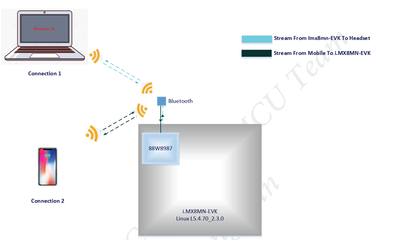

Based on i.MX8MN-EVK And Linux 5.4.70_2.3.0 BSP
As an example of NXP Bluetooth Bluetooth application, this article describes how to use
Bluetooth to realize file transfer between windows PC and i.MX8MN-EVK (linux), and between
Android mobile phone and i.MX8MN-EVK.
The test architecture used in this example is as follows:
The following steps are for the application example:
Step 1 Preparation
 --Downloading DEMO Image For i.MX8MN-EVK
 --Downloading uuu tool
 --Compiling L5.4.70_2.3.0 BSP for i.MX8MN-EVK
 --Copying rootfs to the DEMO Image directory
 --Modifying example_kernel_emmc.uuu as uuu programming script
 --Programming images to i.MX8MN-EVK board
 Booting i.MX8MN-EVK board
Step 2 Loading WIFI/BT driver and Enable Bluetooth
Step 3 File Transter between Windows 10 PC and i.MX8MN-EVK board
Step 4 File Transter between Android Mobile and i.MX8MN-EVK board
[Summary]
More detailed information, see attachment, please!
