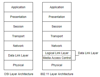

The 802 standard is a family of IEEE standards dealing with local and metropolitan area networks. The protocol specified in the 802 standard covers lower two layers of the OSI model that are Physical and Data Link layers. In the 802 standard, the Data link layer (Layer 2 of the OSI model) has been divided into two parts Logical Link Control (LLC) and Media Access Control (MAC) as shown in figure below.
Figure 1. Layer architecture

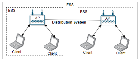

In this mode, devices can communicate with each other first going through AP. In infrastructure mode, the wireless devices can communicate with each other or can communicate with a wired network as it’s communicating through AP. This mode is the most commonly used network mode.
Compared to Ad-Hoc wireless networks, infrastructure mode offers the advantages of scale, centralized security management, and improved reach.
Infrastructure mode has half throughput compared to Ad-Hoc mode.
Figure 3. Infrastructure mode

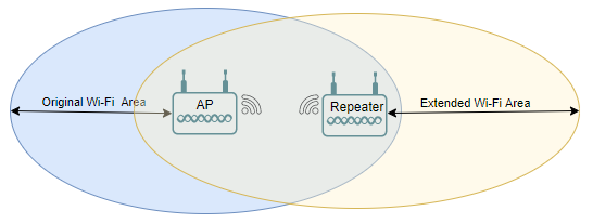

When two wireless host devices have to be connected and the distance between them is long for the direct connection or obstruction is present, at that time repeater mode is used to bridge the gap. Repeater operates at the physical layer of the OSI model.
As a Wireless Repeater, an AP node extends the range of the wireless network by repeating the wireless signal of the remote AP. The Ethernet MAC address of the remote AP is required for the AP to act as a wireless range extender.
The repeater mode has certain drawbacks. Throughput is reduced by at least 50% as wireless interference is at least doubled. The bandwidth of any device connected to it is halved. This is due to the repeater receiving the signal, processing it, and then rebroadcasting it in both directions, from the router to the device and vice versa.
The Repeater must be kept in the range of AP, but not too close to the AP. Distance between AP and repeater depends on the range of the AP and repeater should be kept in such a way that maximum possible area coverage can be achieved.
Figure 4. Repeater mode

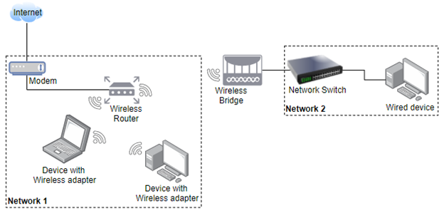

Bridge connects two or more networks to each other. It operates on the Data link layer of the OSI Model.
Bridge mode allows the AP to communicate with another AP capable of point-to-point bridging. An example of this is connecting two buildings through a wireless connection.
Figure 5. Bridge mode
