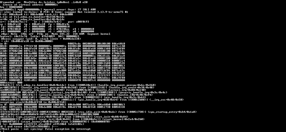

Hello All,
I tried to check if the issue will still occur on the latest kernel 3.13
And the issue occurred immediately with a Kernel Panic see attached picture.

alejandrolozan1
timesyssupport​,
I have reproduced the error. It has been difficult to debug the problem because of Linux. I wonder if you have seen this before.
/Alejandro
