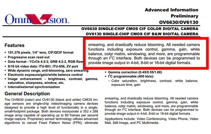

To comply with the rule that mentions that “One processor - No auxiliary processor or other programmable device is allowed”. Participants must check the camera used for the competition.
The camera cannot have a processing unit that processes the image for localization, polarization, auto contrast or auto focus. The only authorization is for a compression engine (no image processing, only compression).
An Analog to Digital external converter can be used. Such as AD7276/AD7277/AD7278.
For any additional cameras, please contact your Regional Freescale Cup Coordinator. They can confirm if the camera can be used and it will be added to this list for further inquiries.
Camera Allowed:
Some restricted cameras and some examples why:
  • OV-2540
    • This camera can be programmed and processes the image output. Not allowed.
  • CM-26N/P
This camera has • Auto gain, • Auto contrast and • Auto focused.

Automatic Gain is ok. But we will need to check that the camera is allowed based on the Datasheet of the image sensor (no localization, polarization, auto contrast or auto focus). Unfortunately I have not been able to find the datasheet either and it will be necessary for us to approve it´s use. Please check if there are other options that you can use, and let us know the part number so we can confirm it´s usage and we don´t have any issues for the technical inspection during the competition.

This camera can´t be used. This camera is programmable and as is mentioned in the Datasheet "This Device can be programmed to provide image output in various fully processed and encoded formats". The only processor allowed to be used is the Main Freescale 32 bit Microcontroller.

Let's all be clear, any camera not on the list above won't be accepted to the challenge.
Cameras with autoexposure and autofocus are forbidden on the challenge. You can add a luminosity sensor and use the signal via the Kinetis MCU to process luminosity if you wish.
