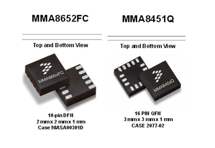

I am just in the process of selecting a new Accelerator.  I have rounded my selection down to two chips, the MMA8652 and the MMA8451.  Am I correct in thinking other than one is 12bit and the other 14bit, and they have different packages, they are both similar in complexity?  My meaning is, one is not easier to program and configure over the other chip.

1. Basically, the main differences between the devices mentioned are the resolution and the package options.
2. In regard with the complexity you mentioned, both of the devices use the I2C interface.
