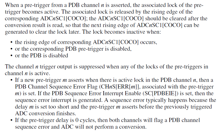

I need to raise an interrupt after 6 ADC sense (6th pre-trigger), but I'm getting a sequence error in this process.
I had the below questions.
1. Do we need to read the ADC Channels (0-7) after every Conversion so as to enable to COCO Flag again? as it mentioned in RM below.
2. What is the minimum delay time between two pre-triggers?
Kindly help in this regard.
Thanks in advance,
Raju
12,066 Views
PetrS
1) yes, you need to read the result so the COCO will be cleared and thus can be set again which makes a pretrigger lock inactive.
2) delay time between two pre-triggers must be ADC conversion time at least.
See chapter 42.5.4.5 Sample time and total conversion time of the RM.

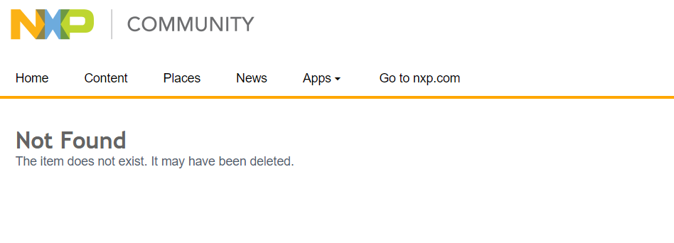

bjrajendra
Senior Contributor I
Hi Petr,
Thanks for the reply.
I tried accessing those
Example S32K144 PDB ADC trigger DMA ISR S32DS
   the link was deleted I guess and below is the display it's showing.
Example S32K144 PDB ADC DMA S32DS.ARM.2018.R1
   the zip file doesn't contain any data
Raju
12,066 Views
PetrS
I have uploaded the first one again, and see no issue with the second one.
BR, Petr

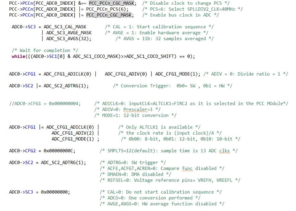

ADC initialization as follows.
Raju
12,065 Views
PetrS
seems you have ADIV=2, so ADCK=10MHz
BR, Petr
12,065 Views
bjrajendra
Hi Petr,
Thanks for the solution. Forgot to change the setting after initializing for calibration.
With 40MHz setting & with PDB Clock 80MHz it requires 104 counts between two delays. I tried keeping 110 it didn't work but it worked with 120 count.
Can I know any possible reasons?
Raju

Dear Petr,
Thanks for your swift response.
I'm using PLLDIV2 which actually generates from 8MHZ External Oscillator & Below are my corresponding settings.
SCG->SPLLDIV = 0x00000302; /* SPLLDIV1 divide by 2; SPLLDIV2 divide by 4 */
PCC->PCCn[PCC_ADC0_INDEX] |= PCC_PCCn_PCS(6); /* PCS=6: Select SPLLDIV2_CLK=40MHz */
Raju
12,067 Views
PetrS
OK, so if you read result registers and the period of FTM is enough for all conversions, then it should work.
If have troubles still please share your full setting/code.
BR, Petr
