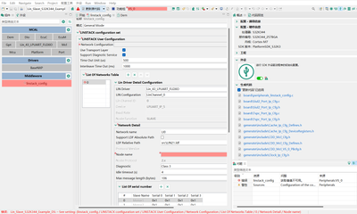

Hello
After installing the LIN Stack, when I open the demo "Lin_Slave_S32K344_Example_DS" mex, a error is found in Linstack_config, pls see below picture.

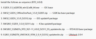

My IDE and packages versions and install sequence as below :
Could you pls give me a hand about this error?

PetrS
if remember well there is typo in the example mex file. So after creating example before opening mex file, manually fix line with ldf path.
This reverse backslash was causing the issue.
Then save file and open mex to see setting.
BR, Petr
