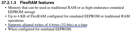

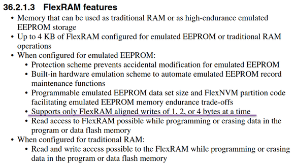

Hi @346500452,
I see now you have the S32K142W part.
There is the FTFM module that supports 32bit aligned writes only.
Unlike the FTFC module on other S32K14x parts:

danielmartynek
Hi @346500452,
