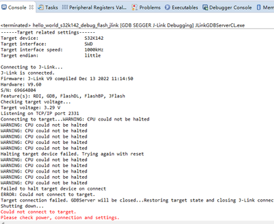

 I want to use jlink to debug the project but the IDE report  some error,
I try to use jlink commender to Unlock mcu,but didnot work,how can i do?
tanks to answer
Connecting to target via SWD
InitTarget()
Timeout while halting CPU.
Found SW-DP with ID 0x2BA01477
AP map detection skipped. Manually configured AP map found.
AP[0]: AHB-AP (IDR: Not set)
AP[0]: Core found
AP[0]: AHB-AP ROM base: 0xE00FF000
CPUID register: 0x410FC241. Implementer code: 0x41 (ARM)
Found Cortex-M4 r0p1, Little endian.
FPUnit: 6 code (BP) slots and 2 literal slots
CoreSight components:
ROMTbl[0] @ E00FF000
ROMTbl[0][0]: E000E000, CID: B105E00D, PID: 000BB00C SCS-M7
ROMTbl[0][1]: E0001000, CID: B105E00D, PID: 003BB002 DWT
ROMTbl[0][2]: E0002000, CID: B105E00D, PID: 002BB003 FPB
ROMTbl[0][3]: E0000000, CID: B105E00D, PID: 003BB001 ITM
ROMTbl[0][4]: E0040000, CID: B105900D, PID: 000BB9A1 TPIU
Cortex-M4 identified.
J-Link>R0
J-Link>swdwritedp 2,0x01000000
Write DP register 2 = 0x01000000
J-Link>swdreadap 0
Read AP register 0 = 0x00000000
J-Link>swdreadap 0
Read AP register 0 = 0x00000033
J-Link>swdreadap 1
Read AP register 1 = 0x00000033
J-Link>swdreadap 1
Read AP register 1 = 0x00000004
J-Link>swdwriteap 1,0x1
Write AP register 1 = 0x00000001
J-Link>erase
WARNING: CPU could not be halted
Erasing device...
****** Error: Can not read register 16 (XPSR) while CPU is running
Can not read register 20 (CFBP) while CPU is running
Can not read register 0 (R0) while CPU is running
Can not read register 1 (R1) while CPU is running
Can not read register 2 (R2) while CPU is running
Can not read register 3 (R3) while CPU is running
Can not read register 4 (R4) while CPU is running
Can not read register 5 (R5) while CPU is running
Can not read register 6 (R6) while CPU is running
Can not read register 7 (R7) while CPU is running
Can not read register 8 (R8) while CPU is running
Can not read register 9 (R9) while CPU is running
Can not read register 10 (R10) while CPU is running
Can not read register 11 (R11) while CPU is running
Can not read register 12 (R12) while CPU is running
Can not read register 14 (R14) while CPU is running
Can not read register 15 (R15) while CPU is running
Can not read register 17 (MSP) while CPU is running
Can not read register 18 (PSP) while CPU is running
****** Error: Verification of RAMCode failed @ address 0x1FFFC000.
Write: 0xA801BE00 F0009900
Read: 0x00000000 00000000
Failed to prepare for programming.
Failed to download RAMCode!
ERROR: Erase returned with error code -1.
J-Link>
