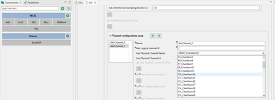

Using as a base project:  "Adc_example_S32K344" and "MR-CANHUBK344 board" I try to read ADC1_S10 :
Potentiometer on the board, but ADC channel does not appear in configuration.

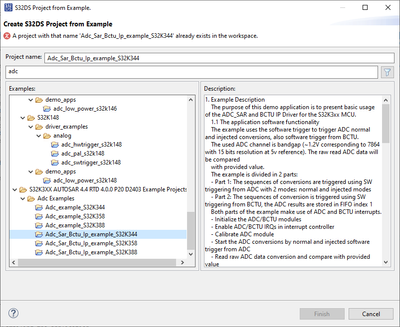

Hi @paulffffff,
Please refer to the example from the RTD package (Adc_Sar_Bctu_Ip_example_S32K344
Which uses the software trigger to trigger ADC normal and injected conversions, also software trigger from BCTU. You can just modify the channel to ADC1_S10 or whichever channel you need in the configuration.

Hi @paulffffff,
You can change the channel from the AdcConfigSet and under AdcHwUnit:
Julián

paulffffff
it does not work in this way.
