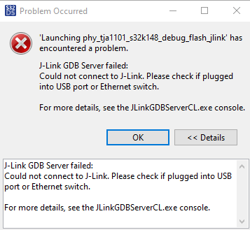

ozancs
Hello @Alexis_A,
It doesn't work with the Run option that you've mentioned. I get the message below.
All the connections for the board are done as described in the example's tutorial page. What could the reason of this error be?
When using the daughter card, I don't know if I should use PHY_Read() or ENET_DRV_ReadFrame(). I will get the data from an Arduino board via Ethernet but the connection between the media converter and the daughter card is done by twisted pair cabels.

Alexis_A
Hello @ozancs,
Usually, the S32K148-EVB uses the PEMicro debugger firmware by default. So try launching this debug session.
The best one will be ENET_DRV_ReadFrame since the PHY_Read is to read specific registers from the PHY.
