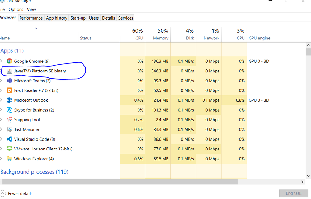

I have downloaded an evaluation version of EB tresos and i wanted to configure MCAL using it. But whenever I try opening the EB tresos gui using ThirdParty\Mcal_S32k\Supply\tresos\bin\tresos_gui.exe the application fails to load.
I am getting image like the one below and application crashes. Have anyone else faced such error with EB tresos?

Yes there was an application named Java(TM) Platform SE binary. I tried killing that process and restarting. It seems to be working now.
However I think I am facing license issue where the application is not generating MCAL source files.

namnguyenviet
Is there any Eclipse application was opening during that time? You can check by Task Manager. The EB application is displayed as a Java application
