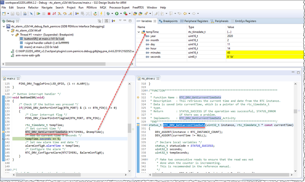

hi,
 I want to obtain the current time by using a function in s32k1xx? Could you help me?
thanks,
jim
1,548 Views
Robin_Shen
Hi jim,
Please check if the rtc_alarm_s32k144 meet your needs.
RTC_DRV_GetCurrentTimeDate
RTC_DRV_SetTimeDate
Robin
