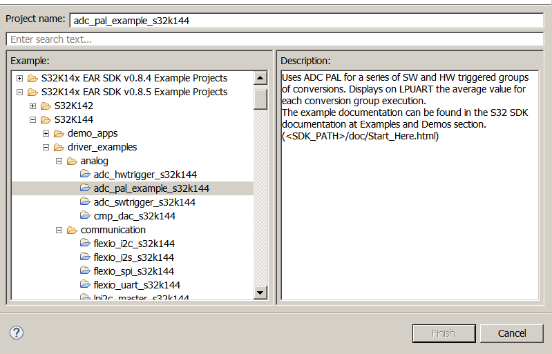

You could also use SDK Peripheral Abstraction Layer (ADC PAL).
Which allows you to trigger a group of ADC conversions with a single SW or HW trigger.
SDK v0.8.5 includes adc_pal_example_s32k144
