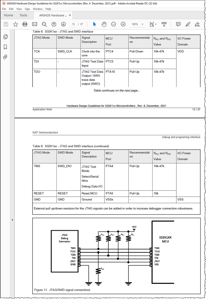

Robin_Shen
Make sure the debug interface is correct. Check all VDD has powered.
Did you ever enable CSEc or secure MCU?

Robin_Shen
SWD_CLK recommend connected external pull-down resistor.
SWD_DIO recommend connected external pull-up resistor.
RESET recommend connect external pull-up resistor.
