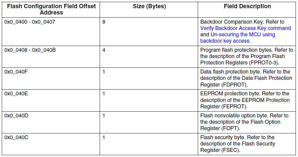

When you are using FLASH operations by MCU - make sure that you aren't modify flash config on address 0x400-0x410. Erase of that area is okay, but make sure that you don't write there data which disable mass erase and secure the chip.

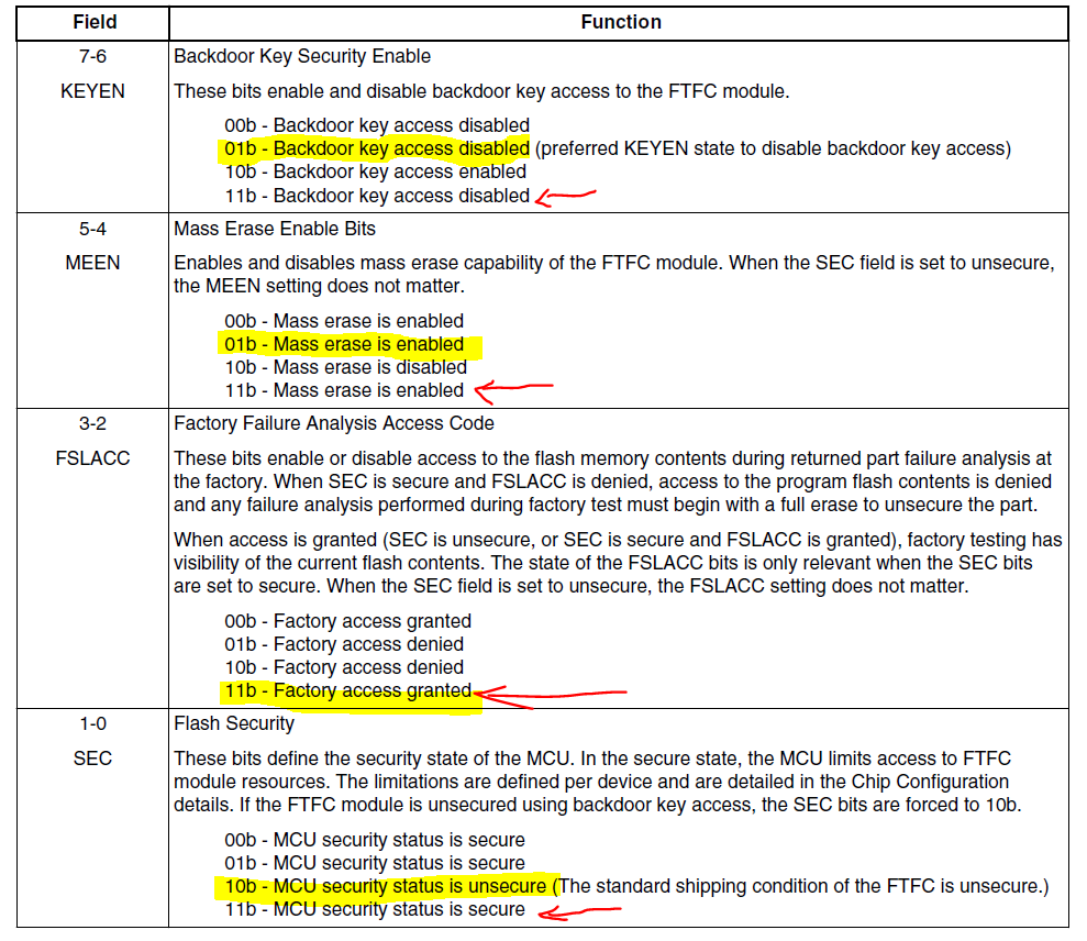

Ok, I understood that whenever I want to program/erase my s32k board, I must pay attention to not secure it, otherwise I could not be anymore able to re-program/re-erase it, if I do not have a backdoor key. The fields that I must pay attention to are in the following figure:
  1. The Backdoor Compartison Key is something similar to a password, that if known permits to unsecure the flash
  2. FPROT0-3 must be at 0xFF in order to not secure the P-Flash
  3. FDPROT must be at 0xFF in order to not secure the D-Flash
  4. FEPROT must be at 0xFF in order to not secure the E-Flash (i.e., the EEPROM backup memory)
  5. FOPT must be at 0xFF in order to not customize the boot options
  6. FSEC is composed as following:
I highlighted in yellow what I want and in red what should happen when I perform a mass erase command (is it true that an erase command will put all flash bits at 1?). You said that an erase of this area is ok (i.e., the erase will not secure the device), even if the mass erase will write SEC = 11b (device is secure).

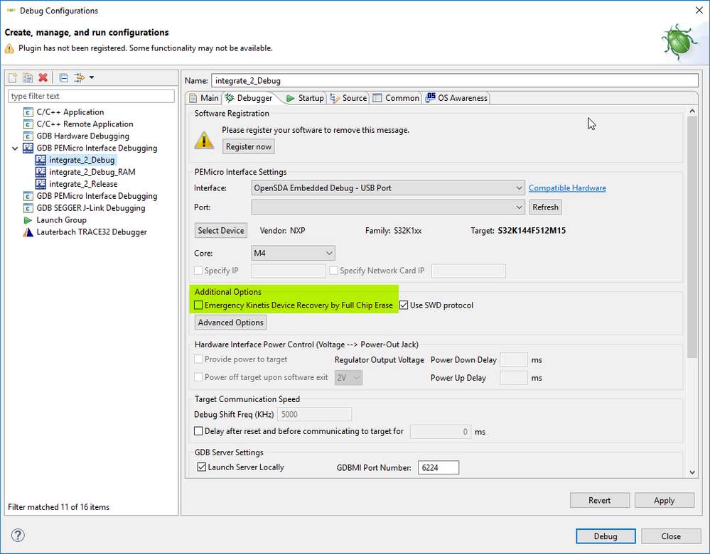

  4. I do not know how to use the Emergency Kinetis Device Recovery. What is it needed for? Why should I use it instead to perform my mass erase operation from inside the application?

actually you need to take special care to MEEN bit, when mass erase is disabled, chip is secured and backdoor key disabled - there is no way back. Secured chip with mass erase enabled is okay.

Ok, so when I erase all the flash content, SEC field secures the chip but the MEEN field leaves the mass erase operation enabled (thus, the example provided with the SDK maybe only wants to show how the flash configuration fields can be written).

4. It is part of debug session with PE Micro debugger. I'm not 100% sure what this option does, but it can erase secured device with key access (jf MEEN is enabled).
