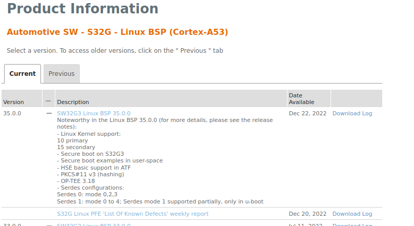

Coco111
Thanks for your help.
but  I can only obtain the bsp35 user manual. please tell me  how get the bsp36 user manual?

Daniel-Aguirre
BSP35.0 also has the previously mentioned chapter 9 for PCIe support [Page 65, BSP35.0 User Manual Updated] under the provided User Manual.
As for BSP36.0, it seems that you are not provided with access to that specific release. If you would like to access it, help us contacting your local NXP representative/FAE, for them to start the process of providing you with the required access.
