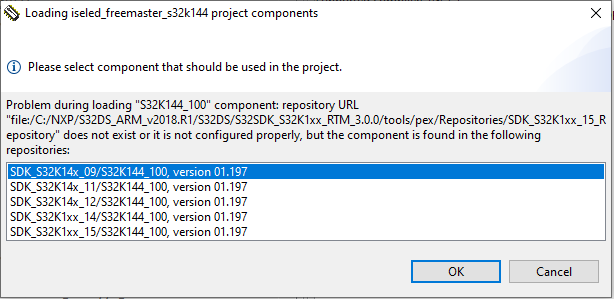

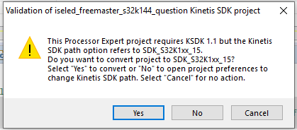

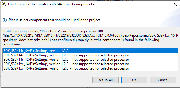

I get the following dialog boxes when loading an example into my workspace. Should this be the case, or is there something I'm missing? What issues could this cause by just accepting each of the prompts? Are there certain repositories I should be selecting that work best with ISELED?

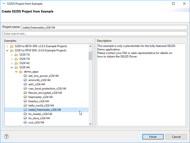

did you updated your S32DS Installation? Easiest way is open existing iseled example from S32DS Installation:

That is the example I try to load, and am getting the pop-ups about. I believe my installation is up to date, is there a certain one I should be looking for?

After you have updated the SDK, then install the ISELED TRM 4.0.0. If you still have those messages click on the newest version of the components. Before compiling the project do a "Clean Project" then click on "Generate Processor Expert Code" icon and then compile the project.

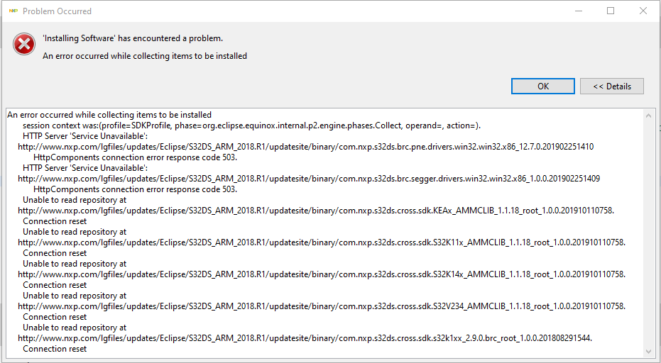

Are there specific updates I need from that list? I have tried downloading the updates from several different internet sources, but they fail each time with this error.
