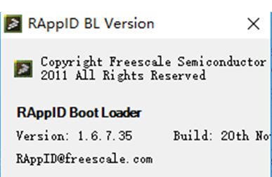

My development is based on S32K144 EVB –Q100. Now I meet a question on RAppID Boot Loader Utility. The version of RAppID BL tools is shown as following:

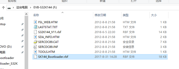

1. insert openSDA USB prot, and there is a mass storage is shown on my computer:
2.I copy SK144_Bootloader.rbf into F disc:

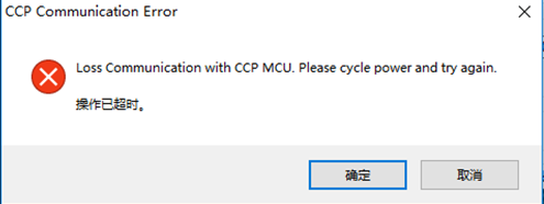

6.but the error is shown as following:
7.I have tried some different rbf file, but the error is always the same. These rbf files are attached.
 Could you help me? my questions are:
1. Is the step 4 right? Should I power off the EVB after copy rbf file into mass storage device?
2.Need I copy *.rbm or rba file into the mass storage device?
3. how can I get the correct rbf file?
Thank you very much for your kind help!

there is timeout for boot loader. Just reset your board and try connection again. The rbf file can be also flashed in s32ds - it is nornmal s-record file. But copy it in mass storage should work okay.
Jiri
