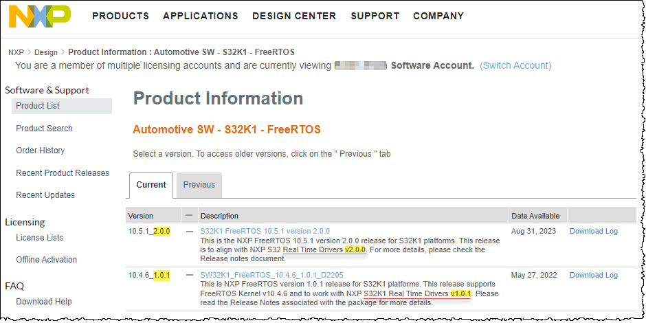

Robin_Shen
Yes. It's confusing because there are many SDK versions and IDEs, and they're not backwards compatible either.
However, for users using FreeRTOS, it is recommended to click the S32K1 Reference Software download link on the S32K1 web page. Then select ->Automotive SW - S32K1 - FreeRTOS
Here you will see that there are only a few versions of S32K1 - FreeRTOS. Install the corresponding version of S32DS\S32K1 RTD according to the content in the Release Note.
After download SW32K1_S32M24x_FreeRTOS_10_5_1_UOS_2_0_0_DS_updatesite_D2308.zip. Please refer to Offline Package Installation Setup of S32DS Extensions & Updates: Explanation and How To Use
