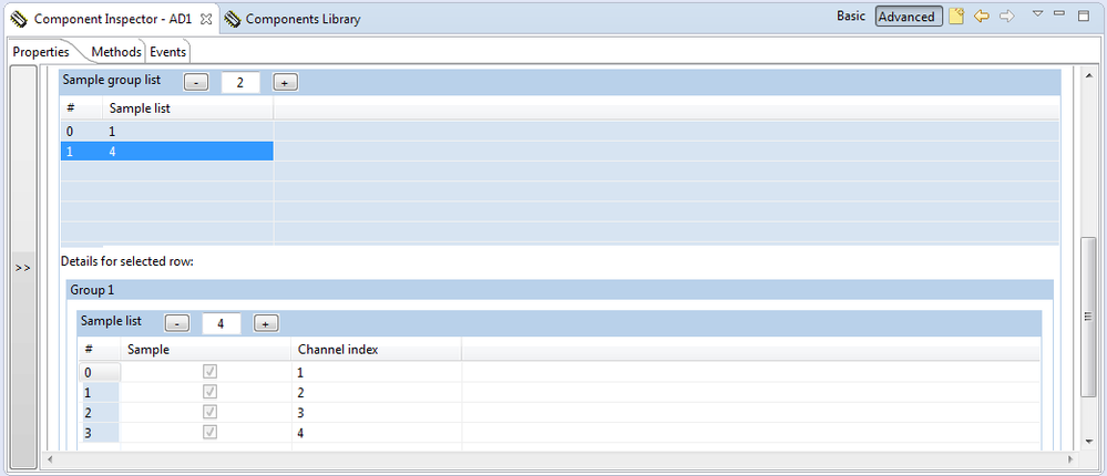

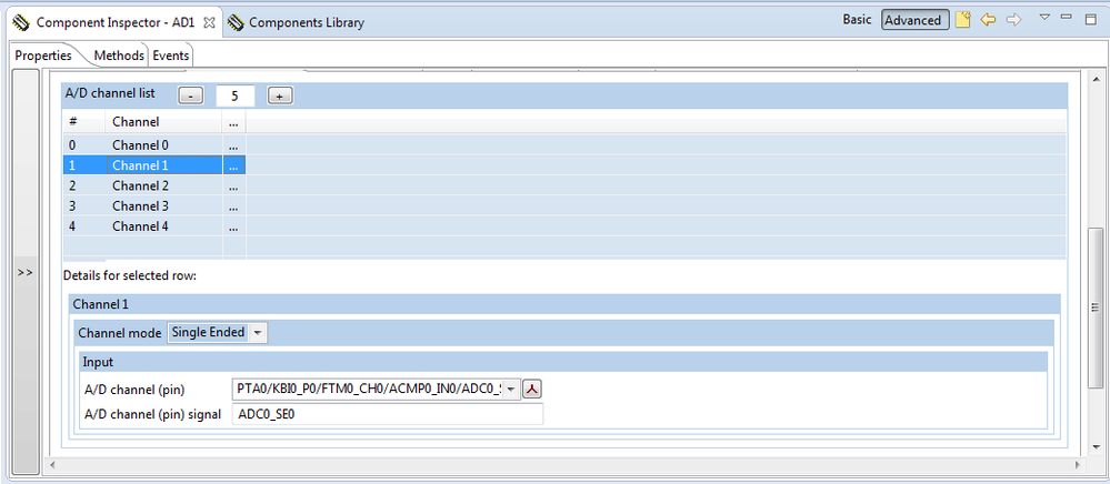

Contributor V
I've configured 5 ADC0 channels (ADC interrupt disabled) on KE02Z+KDS v3.0 as shown:
and defined 2 groups (1st of channel 0 and 2nd of channel 1 to 4)
The goal is to get 1 ADC channel sample every 1ms (timer0 triggered) and 4 ADC channel samples every 10ms (timer1 triggered). Here's the initialization code:

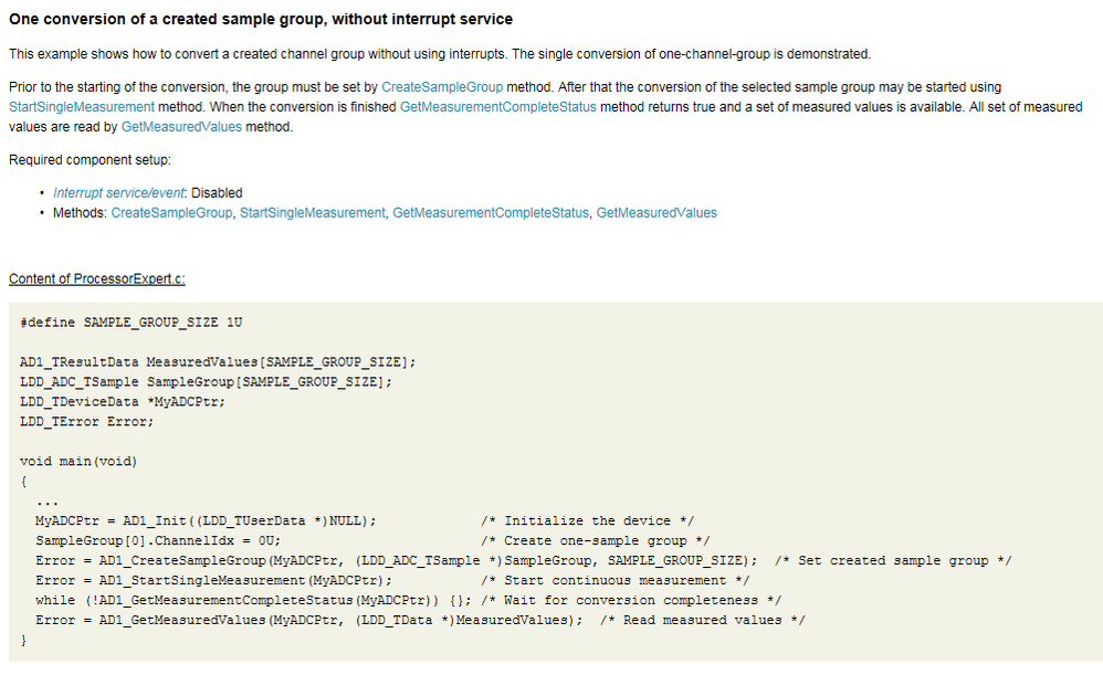

Hello Marek/Alice,
I suppose that you are using the ADC component with interrupt enabled
The ADC interrupt is disabled in PE. I've digged into ADC component help and I've found some hints from the typical usage without interrupt service
Then I rewrite my code as shown (for the 4-sample group 1)

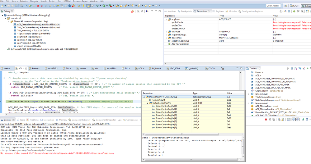

gschelotto
Contributor V
Jorge, it works as expected. Now I get the a correct measurement value for the 4-channel (group 1).
However when I try to get 1-channel (group 0) in Timer1 isr the execution halts this way:
I stepped into AD1_CreateSampleGroup function until the halt occurs and get this information:
regards,
gaston

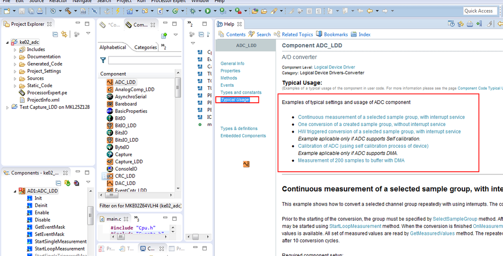

Hello gaston,
Please step over to the function "AD1_GetMeasurementCompleteStatus(AD1_DeviceData)" to check stop on which code ?
And i recommend you refer to theTypical Usage of help on component to configure your code :
Hope it helps
