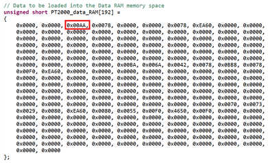

MC33PT2000, During program execution, need to modify some data in DATARAM. While debugging, it was discovered that rewriting all 192 data  to DATARAM was the only effective method. Is it possible to change a specific data in DATARAM Using a simple method? How can the code be written?

Thank you! But, I didn't describe it clearly. Actually, I want to enable real-time data exchange between the microcontroller (for example: S32K144) and the MC33PT2000 (writing data to DATARAM). What method should I use?
